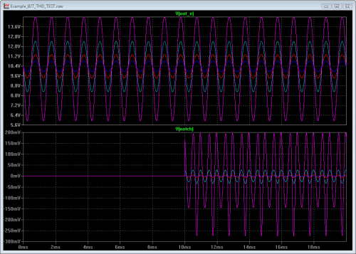

This is how waveforms look after analysis is completed:
Analysis Waveforms after Amplitude Sweep

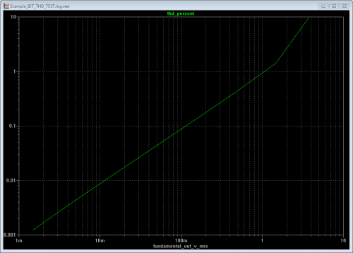

Total Harmonic Distortions vs. Output Amplitude plot looks like this:

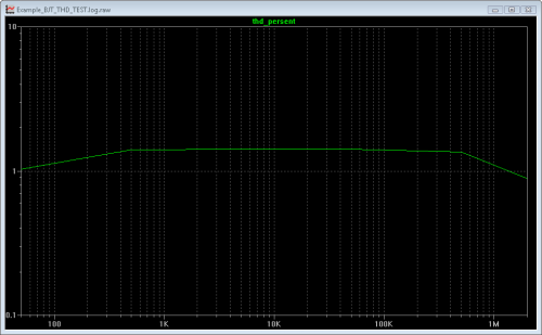

Total Harmonic Distortions vs. Frequency plot looks like this:

Notch output shows residual components, after fundamental removal.
Please note that fundamental may not be removed completely. This is not necessarily affecting resolution of measurements as soon as additional synchronous filtering is used to measure amplitude of harmonics.
Increasing SettlingTime and StrobeLength,  or (and) decreasing MaxTimestep would likely improve fundamental rejection.
