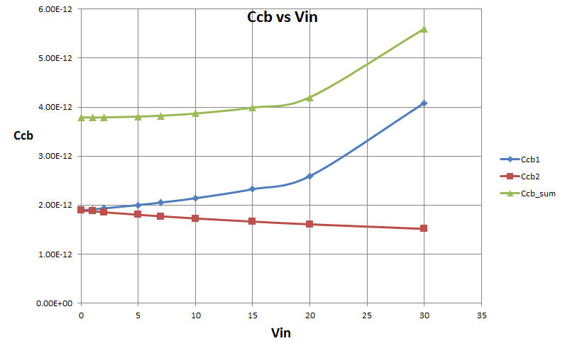

Attached Excel spreadsheet demonstrates this capacitance change in case of topology 1 (schematic 1) while input voltage is changing from 0 to 30 volts. It is also shown in the following picture as Ccb_sum.
Ccb modulation Vs. input voltage

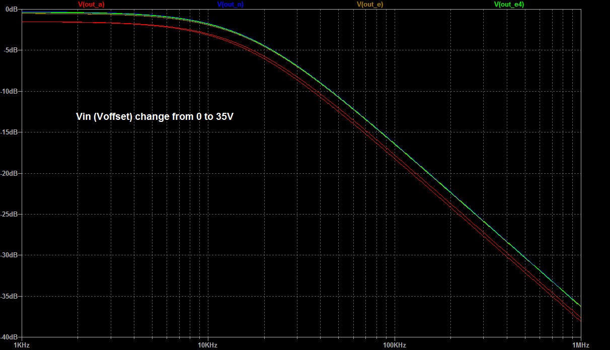

This change of Ccb modulates the frequency response. You can see that different versions of input stage show different susceptibility to this effect. The first one (red plot) is the worst, because it has the biggest change in collector base voltage.  While capacitance change in complementary stage is partially compensated, it is a recognizable change anyway.
Frequency response modulation with change of input voltage due to Ccb change

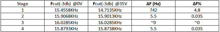

Let’s evaluate cutoff frequency change for all versions of output stages while input signal (offset) changes from 0V to 35V.

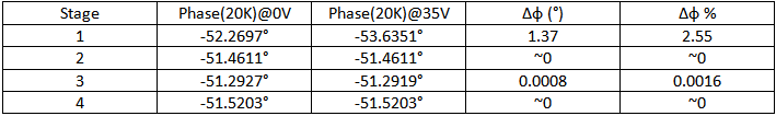

The other interesting measure is modulation of phase shift with the same input signal change (0 to 35V).
Test frequency is 20 KHz.
As you can see, topologies 2, 3 and 4 show big advantages over topology 1 in both tests.

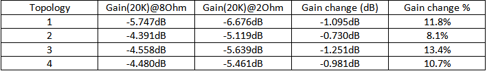

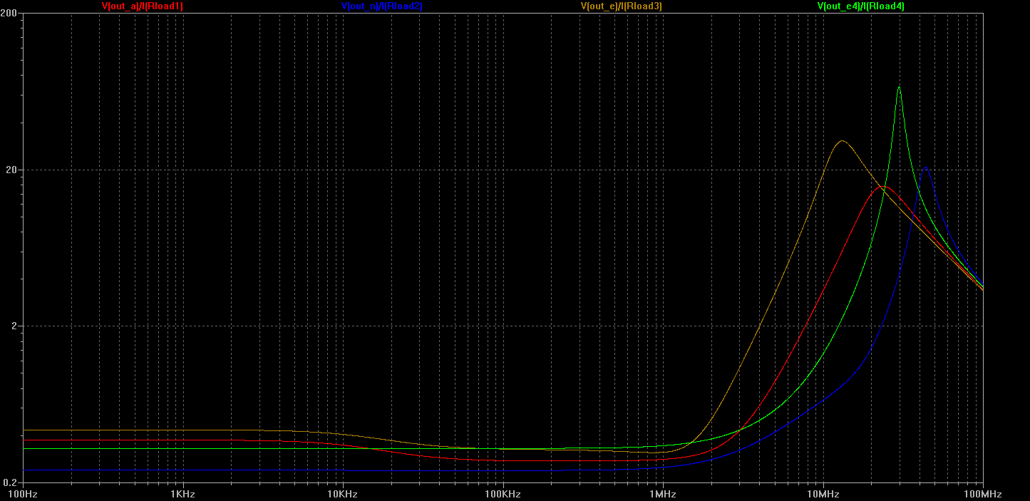

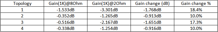

Load influence.
Next set of tests is related to change of small signal transfer function, while driving different loads. Two loads, 8 Ohm and 2 Ohm were selected. While 2 Ohms may seem to be extremely low, many 4 Ohm loudspeakers may have impedance, close to 2 Ohm at some frequencies. The other reason is to emphasize potential problems (if any), common to particular topology.
Let’s evaluate performance of all topologies at 1 KHz first. Offset voltage is 0 V:
And with offset voltage of 35 V:
For 20 KHz with 0V offset results will look like:
Results for 20 KHz with 35V offset:

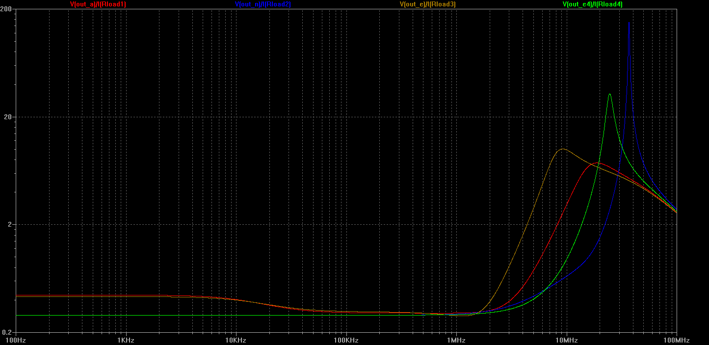

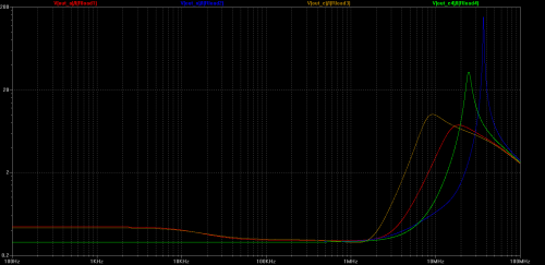

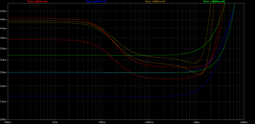

Output impedance.
Results of previous tests show importance of output impedance evaluation. Small signal AC voltage source was inserted between load and ground to inject test signal. Output impedance was evaluated as ratio between voltage at the output and current in the load, while making AC sweep of added voltage source.

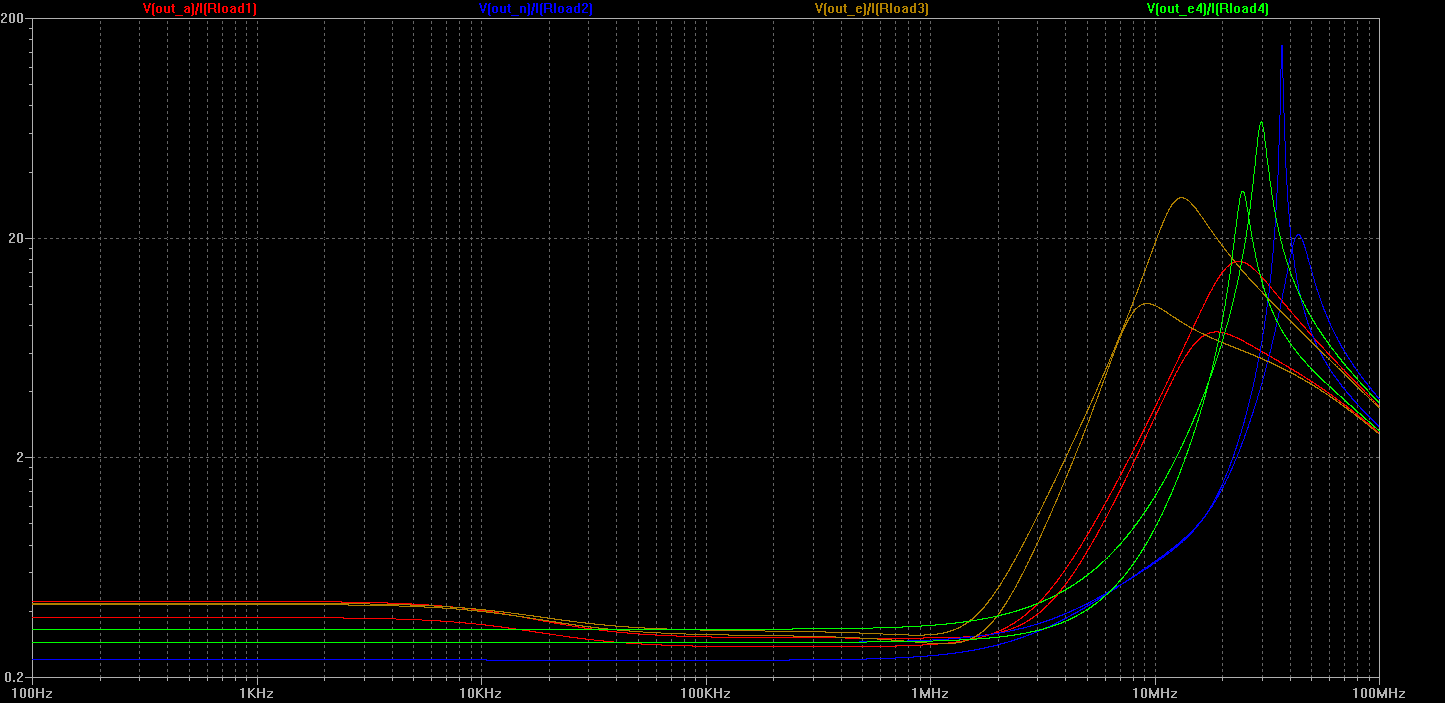

Results are represented in the following picture. It shows 2 set of curves, with 0V offset and with offset 35V.
Output impedance, 0 and 35V offset
Separate curves with offset 0V are on the next picture.
Output impedance 0v offset
Separate curves with offset 35V are on the next picture.
Output impedance, 35v offset
The last picture shows low frequency portion of the first one, 0 and 35V results together in zoomed form.
Output impedance, 0 and 35v offset, LF zoom
